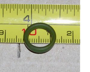

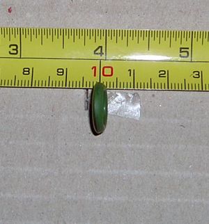

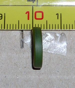

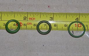

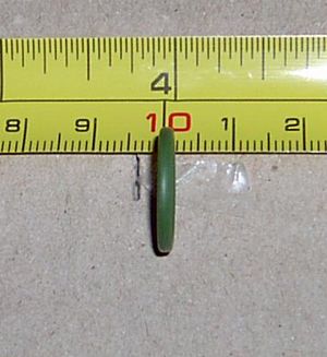

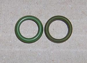

Thank you RB,
Here are some photos, not easy to get good shots because i do not have macro on my camera. Slightly larger images if you click on them.
Here are the two from the condenser fittings, these are not spring lock fittings. These are the ones that i think have an ID of 10mm, the thickness seems to be around 2.5 - 2.8mm. Though they look slightly different in the pictures, i think these two are the same size, they have just been deformed differently.
The one on the right is from the spring lock fittings. (The image below).
More of the O-ring from the spring lock fittings. It looks like it's ID is around 14mm, with a thickness of just under 2mm.
Hope the photos are helpful. Both of the condenser ones are deformed, and one of them is pretty hard, so no doubt need changing. The ones in the spring lock connection also seem a little deformed, so i may as well change them all whilst i can.
There are 2 spring lock joints i have apart, each one contains two O-rings, so that's 4 of them i need. The condenser just as the one O-ring per fitting, so that's 2 of those i need.
Thanks again RB, i will send you a PM regarding your offer of help.
