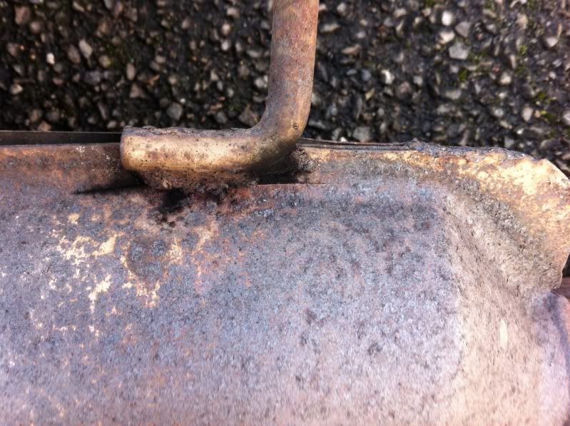

Quick pick of the sills, need to straighten up and paint the lip on the rears, someone has been at it with a jack.

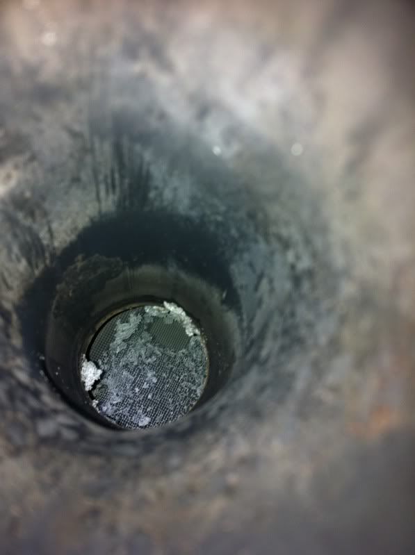

Right updat.
Money spent so far :-£0 :biggrin:
Had a bit of a discussion about with my mate from the garage.
After initialy think coil pack a blocked cat seemed to also fit the problems, that and the coil pack they had up there was the newer type with the smaller ht terminals on.
Here is a pic into the cat.
Also there is a crack on the top of it so it will need to be replaced at some point.
A short time later with some extension bars from my socket set and it's kind of fixed.
As it stands ATM it now revs very well with no holding back, although it still has a bit of a missfire while doing it.
Could well explain why it had a new complete exhaust.
Guess the last owner decided that having to but a cat on was the last straw.
Kids were jumping up and down say "stuff is coming out the exhuast", I said "don't be silly" turns out it was me being silly and lumps of very burnt cat led on the floor.
P.S. before anyone puts up that I left some in thedown pipe - SHUSH!

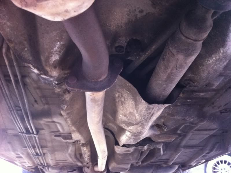

One more pic.
Very rot free underside :smoking:
